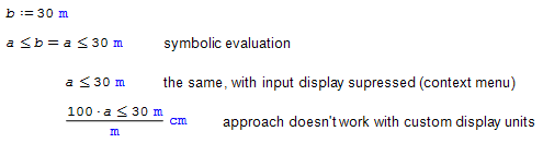

#4 Posted: 1/23/2021 11:14:58 AM
1,332 likes in 2,241 posts.
A very limited native solution
Blatt2.sm (4.65 KiB) downloaded 743 time(s).
