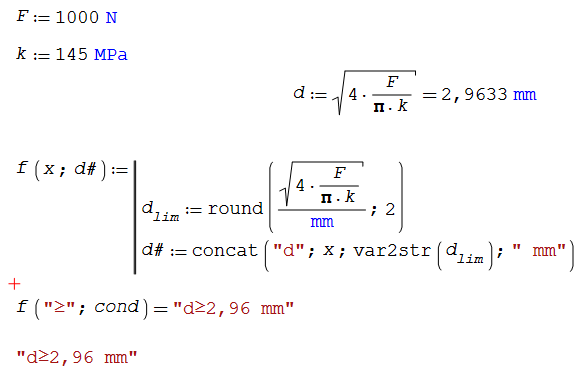

it's just a cosmetic solution

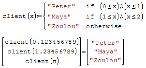

disuguaglianze.sm (5.31 KiB) downloaded 1098 time(s).

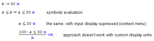

A very limited native solution
Blatt2.sm (4.65 KiB) downloaded 1155 time(s).
