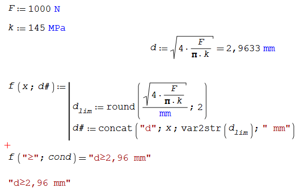

how can I solve simple inequalities, like the one below, in SMath Studio ?
Of course I could simply use equality sign to get the same result here but I guess that it's possible to do it normally as well.
Thanks in advance for your help

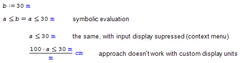

#3 Опубликовано: 23.01.2021 05:56:50
it's just a cosmetic solution

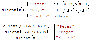

#4 Опубликовано: 23.01.2021 11:14:58
A very limited native solution
