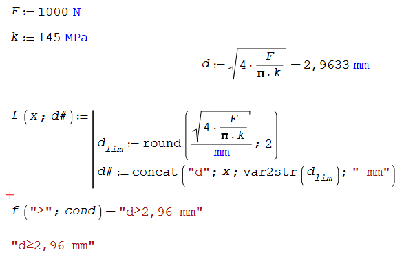

how can I solve simple inequalities, like the one below, in SMath Studio ?
Of course I could simply use equality sign to get the same result here but I guess that it's possible to do it normally as well.
Thanks in advance for your help

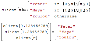

it's just a cosmetic solution
disuguaglianze.sm (5 КиБ) скачан 64 раз(а).

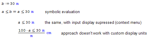

A very limited native solution
Blatt2.sm (4 КиБ) скачан 62 раз(а).
